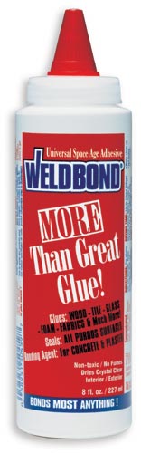

Has anyone tryed the weldbond products?
They have this universal adhesive as well as a white glue.
PostPosted: Wed Jan 11, 2006 8:28 am
Posts: 8553
Weldbond was recommended to me by John Greven for inlaying rosettes.
